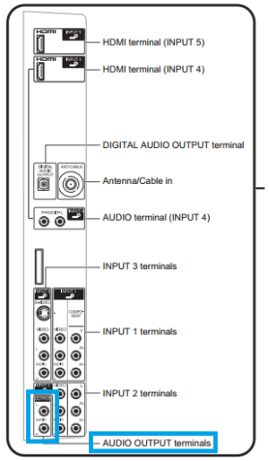

I really think it is the TV. The reason I say that is because there is no doubt that the CC is working, it is just the TV isn't passing the PCM stereo stream down the SP-DIF optical connection. Technically it shouldn't either as DD+ can't be sent over optical. It would have to be decoded down to Dolby Digital 5.1.
I pulled up the service manual, and extracted the image below. Does the receiver get the audio if you connect using the analog ports in the image. Like I said earlier I have experienced the same thing with my TV. I can't tell you how shocked I was above when I tested the hunger games and it finally pushed the stereo PCM audio. Before that occasion I had never gotten it to pass anything other then Dolby Digital 5.1 from OTA broadcast TV.
If the Analog ports work, it would be basically the same as the optical can allow. You would just have to remember to change the source. Then if you want surround I am sure the Yamaha reciever has some virtual options for it.
