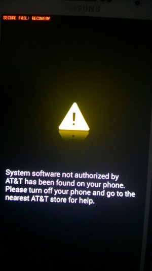

Hello guys!, I'm new here and in the android world, but not to the cellphone world. Thing is that I have the same problem, BUT I think I have this problem because of what I did. I have a N900a (AT&T Note 3), I read about CWM and decided to install it on my phone, BIG MISTAKE, after that, and a Warning fro AT&T, I realized that my Bootloader was locked. Now KIES 3 won't recognize the phone at all. Is there a way to go back to the RECOVER STOCK?, I know I tripped KNOX, I actually don't care. Can anyone help me?is there a thread that can solve this?. Thank you for your time, I appreciate it!!!WP_20140611_003.jpg WP_20140611_005.jpg
