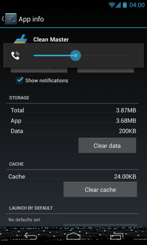

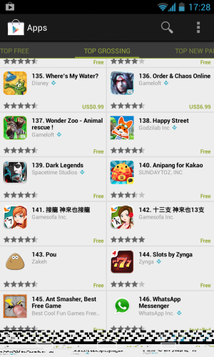

hi guys, i just got my nexus few days ago and i realize there is some kind of graphic glitch (picture below) on my navigation bar. it doesn't happen all the time tho but randomly...
any idea what causes this and is there solution for this? i'm running on full stock (N/A), no modification done or what so since i got my nexus 4. finger crossed hoping this is not a hardware problem...
p/s: i had tried factory reset but no luck...:'(

since you were able to screen shot it with the issue reproduced in the image its not a HW issue.
Do a factory image restore http://forums.androidcentral.com/ge...er-factory-restore-root-any-nexus-device.html
