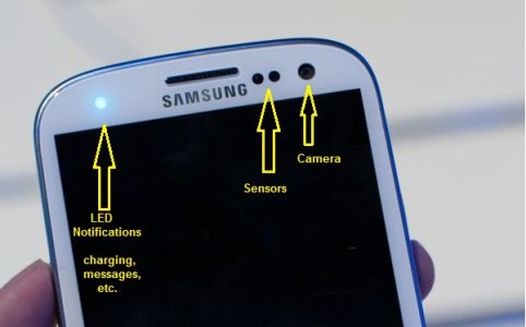

The S3 has LED lights on BOTH sides of the phone. LED Notification lights on the LEFT side that indicate charging, messages, etc and smaller LED Sensor lights on the RIGHT side next to the front facing camera. The original posters issue was with the smaller LED Sensor lights on the RIGHT side next to the front facing camera that are on for no apparent reason; NOT the notifications lights, solid or blinking, on the LEFT side of the phone. The sensor lights on the RIGHT side of the phone next to the front facing camera on ny daughters S3 are on more than they are off. We have done a factory reset, and checked as we reloaded her common apps 1 by 1 and these sensor lights seem to have no preference to which app is installed when they come on. Its random. Reboot the phone and they are off, set the phone down and leave it alone and 1, 5, 20, or maybe even 60 minutes later they are on. No idea why.s3leds.jpg
