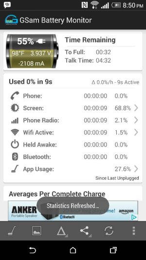

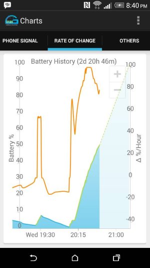

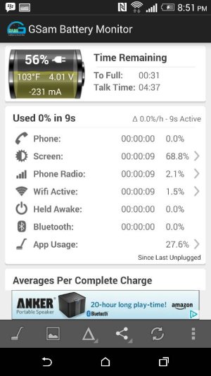

It works. About 1.75-2.00 times faster. Went 2%-50% in about 25 minutes.
Long version.
Comparison of Moto Turbo to Anker Wall Wart and also BlackBerry Premium Charger 1.8A. Wires used are both the one that came with the Moto Turbo and a premium Monoprice one.
With the standard high quality chargers, I achieved max rate of change of 55-60% and about -1000mA.
With the Moto Turbo, I achieved -2100mA and 100% or more max rate of change. I say "or more" because it looks like the chart on GSAM maxes out at 100%.
The results were duplicated between the Moto Turbo wire and the Monoprice one, so the Moto wire doesn't seem special.
See attached screenshots.

The first three screen shots are with the Turbo. The third one shows how power input rate drops at times. Same happens with the standard chargers.

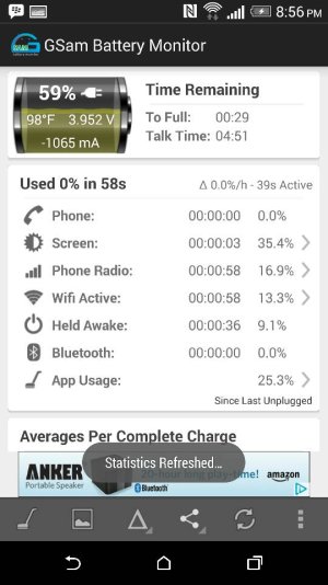

Last shot is max speed on a standard charger.

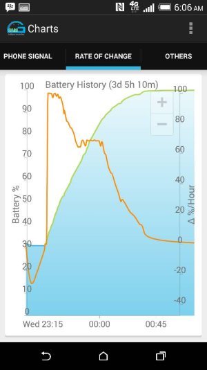

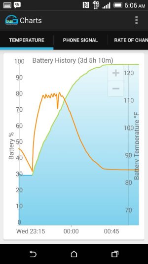

No blob. Charger performed well overnight. Went 30-100% is about an hour and 15 minutes, but looks like to about 85% in 30-40 minutes. Rates of charge >100%/hr, temp around 112°F but dropping as charging slowed.
I am pleased with QC2.0, and this will be my travel charger for quick top ups on the go^^^
