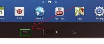

Go to Application Manger in Settings and select the All tab (note:there will be downloaded, sd card, running and all) then touch the three lines on the left of the home button download.jpg and choose reset app preferences............
Hope it helped:)
