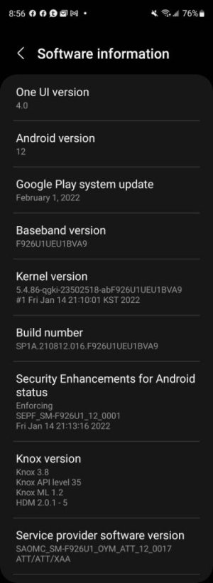

It shouldn't because it configure any sim u install and all unlocked version are on same bootloader regardless carrier your on . Maybe there a issue with the newer firmware try going back to last one
This build I'm on
If you can take a screenshot of Odin with Verizon build , I don't have my computer home with Odin, everyone have all apple here lol
I think there something off about Verizon build Screenshot_20220326-205609_Settings.jpg
This build I'm on
I think there something off about Verizon build View attachment 343526
Awesome that's what I have downloaded, just gotta grab Frija and my work PC to revert back. That's what I'm thinking is the issue also, especially since I didn't have any connectivity issues a few weeks back on T-Mobile prior to the new Verizon OTA.
Tomorrow I'll look in Verizon build but something was wrong I believe the end was cvc5 but before those numbers this in frija by the way before downloading was BVA9 somewhere in there
Yeah looks like BVA9 is the latest OTA for T-Mobile, I'll backup via SmartSwitch then Odin it to see if it fixes the issues.

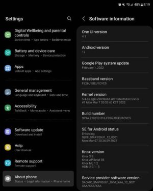

I had HORRIBLE connectivity issues on my Fold 3 after Android 12 update. I had to Airplane Mode almost every time I left my home (where I have WiFi). I rarely ever got connectivity without doing this task. I tried the manual fix that is floating around, but it was worse. I never got 5G and I still had to airplane mode it less than before, but connectivity sucked.
After the 4.1 update (I am on T-Mobile Locked). I now no longer have any connectivity issues when I leave my home. I now get 5G UC here like I should and everything is working fantastically!
This update fixed all of the issues I had before.
Good to know! I also believe being on a MVNO (US Mobile) is also affecting my data connection. I will be jumping onto a T-Mobile post paid Magenta plan here in a couple days and after I get this update I hope my issues are fixed. I am currently on US Mobile under T-Mobile's GSM LTE and haven't received the 4.1 update yet and plan to wait to update once I get under an actual T-Mobile plan.
