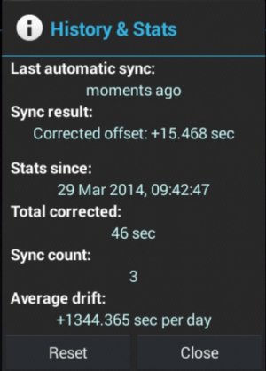

I found an app called ClockSync by Sergei Baranov( free in google play) that syncs system clock to atomic clock. Have it installed to,see what happens to the clock lag. I will report back after a few days to see what effect it has.
Re: [ROM+Kernel][CM-11.0][4.4.2][OS2SD/internal]OV-KitKat (JBC based)
I manually did a sync to allow superuser, then set to "automatic" at 15 min intervals. Manual sync does restore correct time, will have to see what auto mode does. Settings can be set to as low as 30 sec, not sure what that would do to bat life.
I am testing it too (thanks) because the clock lag is a real pain for me. I have to set a secondary alarm on another device on weekends.
My time was off by 16.x seconds when installed. Set it to 30 min intervals.

Really impressed so far, has corrected the time 3 times in a short span. Seems like automatic mode overrides the selected time intervals as I have it set to 15 min but it's corrected it in less time, well I guess automatically. Keeping fingers crossed.

Update on clock lag: seemed to work for a while then starts to lag again. I am now going to trial with "automatic time and date" option under system time and date settings unchecked. So far after 2 hours no lag. ClockSync actually wakes up device screen when updating.

I started with those unchecked, and had to turn the sync interval down to 15 min. I got lag once already too. I have screen on turned off in the app settings.

Seems to be doing better with automatic time and time zone turned off in the system "time and date" settings. I also downloaded the "use offline database" option that's in the ClockSync settings. I left the high precision option checked( which is what wakes up the screen) as it's supposed to decrease latency according to the FAQ section of the ClockSync app. This is a technical little app, going to take me a bit to figure it out. Also AndyOpie how is it that you don't have any clock lag? The only variables I see are fly-on mod, smaller sd card and internal install. Andy, can you confirm after several days that there is no clock lag? That does not make sense since it's the same ROM and Gapps/ hardware and kernel unless the way we install the ROM has something to do do with lag.

Lag issue- ok I have the ClockSync app,enabled with offline database downloaded and enabled. In system settings I have unchecked automatic time and time zone updates. Turned wifi off last night before going to bed, this morning upon turning phone on the usual lag present but upon enabling wifi the phone instantly syncs to correct time. My guess is that with these settings and wifi on( no deep sleep) the correct time would remain and the alarms would work, But you would need to leave the phone plugged in. Either that or using an atomic clock alarm(don't google this unless you want NSA after you lol) if one exists. Why is it that with a a GB ROM like mirage or harmonia you can leave wifi on and enter deep sleep cycles and experience no clock lag. Can we see what part of the code is driving this function in those ROMs and apply to this ROM?

Yeah, that would be epic. I would like to know why the system clock is consistently up to 16 seconds off as compared with the atomic clock. So far the ClockSync app has delivered almost 90 corrections in a couple of days. Definitely something to do with deep sleep. It's not hardware because froyo and gingerbread did not have this issue. When I googled this issue I found that people were reporting this in google forums(mostly nexus 7 and samsung devices since 2011 all the way to Jan of this year. Google finally responded a full 2 years after people started posting with the lame suggestion to do a hard reset or try manually setting time date followed by reboot. The app ClockSync was born out of that. Amazing!!!
