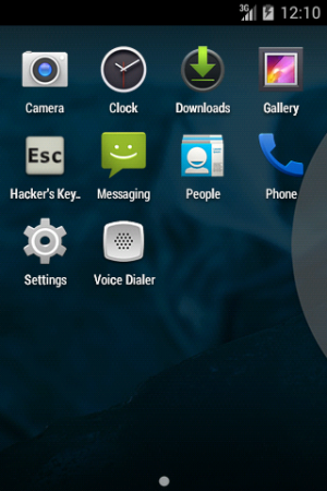

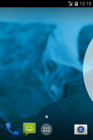

Ok, y'all. this is most likely the LAST internal build.
cm-11 RC10. Very few apps built in. /system and /data are reversed in the kernel from the original Optimus S/V partition map to squeeze a few extra MB into /system. When I say very few, I mean very few. Everything else, that would be built into the os2sd setup, is in the ROM zip file in the /extras folder. You can extract the stuff from /extras/app and install it with the filemanager if you want.
Screenshots of how puny it is:
Download link here. Shared folder.
current: cm-11-20141014-EXPERIMENTAL-bigsuperROM_internal-thunderc.zip
YOU MUST USE THIS RECOVERY for recovery issue support.
Skinny gapps here
mine takes around 5 minutes for first boot (!) but I've heard up to ten minutes. Hope you enjoy seeing that CM logo spin :p
