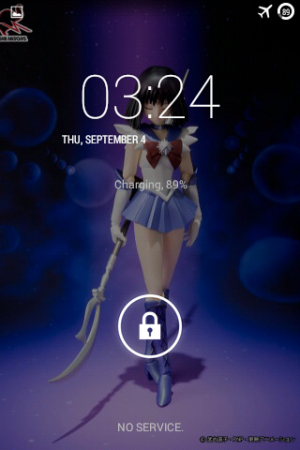

Yeah, I forgot to mention it (because I wasn't able to attach the pic), but the lockscreen clock's not quite perfect. The date isn't centered properly, which is odd because I know previous versions had all that on point (the internal builds did, anyway).
interesting, didn't spot that.
probably an overlay issue but dunno yet.
