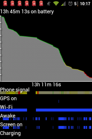

Coming from Bobz' very awesome CM10... but with 5-6 hour battery life... can't go back! Thanks mrg666 :)
