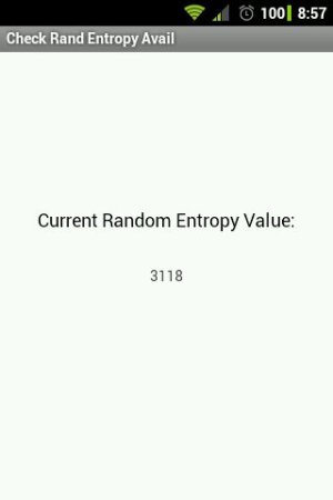

Ok, I'm getting inconsistent results. I tried Seeder again and was able to consistently see entropy pool values around 3500-4000. Then I uninstalled it and the entropy dropped back down 130-200.
This morning I decided to check and saw the entropy pool rise slowly from 400 to 3100.
Last night I uninstalled ivona voice because I didn't like that it was running as a background service but that is the only difference. Wondering how much of an effect certain applications have on entropy.

This means the entropy patch in the kernel is working. Probably something was using too much entropy. Maybe ivona was the problem. I have been using svox classic without any problems, but I had to buy a voice (Grace US).

Entropy Seed Generator Not All It?s Hacked Up to Be
I just happened to come across this article today after installing the new kernel. Curious what the experience of others has been. The phone seems a bit faster to me, but according to this, the entropy change has nothing to do with it?
Entropy Seed Generator Not All It?s Hacked Up to Be ? xda-developers
The premise of the hack is that you can reduce lag by keeping a section of the Android file system (/dev/random) full of random bits so that the system does not have to wait for the file system to generate them. In theory that sounds great, and has shown some success in certain areas where lag was obvious, but it presents all sorts of other problems.
It is for those concerns that we do not recommend using this fix. The fix itself in no way causes harm, and is near-placebo in its effects. CyanogenMod developer arcee posted information on the fix, stating that
The only users of /dev/random are libcrypto (used for cryptographic operations like SSL connections, ssh key generation, and so on), wpa_supplicant/hostapd (to generate WEP/WPA keys while in AP mode), and the libraries that generate random partition IDs when you do an ext2/3/4 format. None of those 3 users are in the path of app execution, so feeding random from urandom does nothing except make random? well? less random​
There are valid concerns about lag and how the Android OS handles them, and there is discussion currently ongoing within the Android Code about this, but this fix does not address those issues and instead gives performance gains through boosting CPU speed. The developer himself stated that this could in effect reduce battery life, since the hack is waking the CPU every second.
Re: [ROM+Kernel] MiRaGe-CM7.2-IHO
The entropy fix in this kernel is not the same as seeder. It is a fix for the underlying problem of why something like seeder was created in the first place to keep the entropy from dropping. It does not cause the CPU to wake more often than before like seeder did and it is not possibly diminishing the randomness of /dev/random.
Re: Entropy Seed Generator Not All It?s Hacked Up to Be
Yaconsult, the discussion you have linked is about the seeder app and I actually agree with the CM developers that it is an ad-hoc fix. I wouldn't include in MiRaGe. See my earlier comments here.
What I have included in the MiRaGe kernel is a patch that addresses the entropy depletion problem in the kernel level taken from LKML. It will probably be included in the mainline Linux kernel soon. This patch is not even specific to Android. So, skeeterfood is right. There is no change on the Android side since the problem is addressed at its root.
