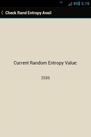

I just can't seem to figure out what's constantly using my entropy then. I've disabled/force stopped/uninstalled all but the basics, rebooted, and still get 150 - 200 for entropy_avail...

Enmod, are you sure seeder app has been removed properly and no links left in / dev? If that is not the cause you might try a clean flash after a nandroid backup and restore your apps/mods/themes one by one.
Re: [ROM+Kernel] MiRaGe-CM7.2-IHO
I wasn't sure if I uninstalled it properly, so I just went with a fresh flash after flashing LeslieAnn's Prep_for_new_rom zip. Flashed the latest build, flashed official gapps, booted, and went into the terminal emulator to use the cat command that would give me the current entropy. It was ~3500 as expected.
So I then went about messing with system settings, configuring them as I normally would. The first and only app I installed next was the entropy checker app mentioned earlier in the thread. It displayed the entropy building up to ~2100 slowly as you described, which confused me. Why was the upper limit suddenly lowered by ~1400? Disregarding that I exited the app and tried the cat command again, to see if something went wrong. Entropy was dropping with each successive use of the cat command, starting from ~1700 and dropping by ~30 each time; I stopped when it hit ~1500. Knowing this was the wrong behavior I tried the checker app again, out of curiosity. It displayed the entropy available with an upper limit of ~400, decreasing eventually to the range of 150~200 I mentioned before.
I tried uninstalling unnecessary apps, like live wallpapers, Gallery3D (I was going to for QuickPic), VoiceDialer, even the checker app. But when I went back into the terminal it showed the same results as the checker app: 150~200
Was it something I changed in system settings that is causing all this entropy use? I only adjusted the Notifications Power Widget, changed my CPU settings to 245-806, and activated WiFi, setting sleep policy to Never...I doubt it though. Idk what else could be keeping my entropy at a limit of 150~200 though.
These links you're referring to in /dev.....
What would one look for to delete? and/or what shouldn't be there?
I installed the Seeder app almost a month ago now. I did the uninstall via Link2SD and since then was when you had made the kernal update. How would you know if there is somehow any sign(s) or traces of it left?
I took this SS when it was going well...however, when I do check it at times, it still seemes to be all over the place. Doesn't stay "low" though as some have mentioned here.
Linking /dev/random to /dev/urandom was another method used along with seeder. If you have not done that don't worry about it.
Regarding entropy going up and down, that is normal. The kernel patch is not overaggressive about keeping the entropy level always at high values. When there is high demand the entropy level can go low, this is expected. Keeping the entropy always high will cost cpu load and battery life. But I have not observed depletion with this patch yet. That is the point.
