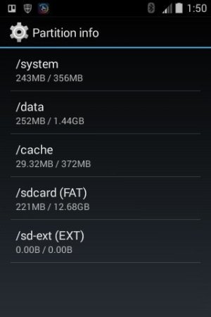

Here is a pic of the storage. Great numbers.

Wifi should work just fine - the known issue is that the password is not retained after reboot until you follow the instructions in this post by skinbark: wifi fix But I should mention that I am running the os2sd version on my test phone - have you looked at it yet?
