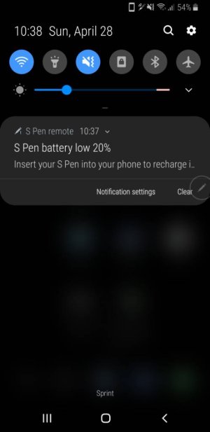

For some reason I got the attached message even though my S Pen wasn't detached and fully inserted. Hadn't been using my s pen prior either. Indicator that the s pen battery is finished?Screenshot_20190428-103801_Samsung Experience Home.jpg
For some reason I got the attached message even though my S Pen wasn't detached and fully inserted. Hadn't been using my s pen prior either. Indicator that the s pen battery is finished?View attachment 302528
Withing a moment of that that battery went to 1%.
I removed it from the folio case , removed pen and re- inserted and all issues went? Weird.

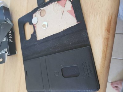

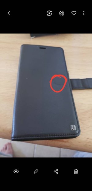

I figured it out. It was the multiple magnets on my Unique London wallet folio case that was causing all these issues. No wonder it was so cheap on Ebay.

Other anomalies are also occurring. For example when closing the case cover screen write would activate 50% of the time.
I noticed that this folio case had a button size magnet on the front and back cover . It was put there for the latch. Note to stay away from those. In the past my folio cases has a discreet magnetic latch which didn't fold under or over the case hence no issues then.
