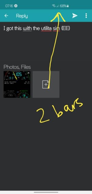

I only get 2 bars on both 3 and with that Utilita sim card but I really have no antenna issues or call quality issues. The same sim in an iPhone 7 still only had 2 to 3 bars and that is an old iPhone. So I think their reporting is different between iPhone and Samsung. Are you able to make calls?

I got this with the utilita sim (EE)
I am not sure it is the phone to be honest, but I am not sure another phone would solve the issue.
