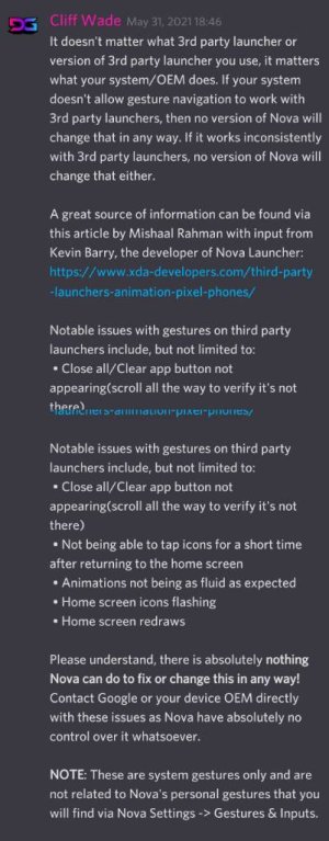

The same issue. The only fix for now is slow a little bit... I mean wait half a second before clicking next icon. Any improvement with Nova 7? Thinking about installing beta, but I'm not sure if it's stable enough?
System gestures and third party launchers don't work perfectly after Android 10. The blame is on Google and their implementation of Quick Switch. Unfortunately there's nothing that launchers like Nova can do about it.
It depends on the OEM on how decent the transitions will be, specially the home gesture, but there will always be some jumps and redraws.
With Nova 7 I experienced a bit of an improvement, but mostly because the new version is faster and more fluid and because I use a OnePlus phone.
This is the explanation from the Nova guys.
