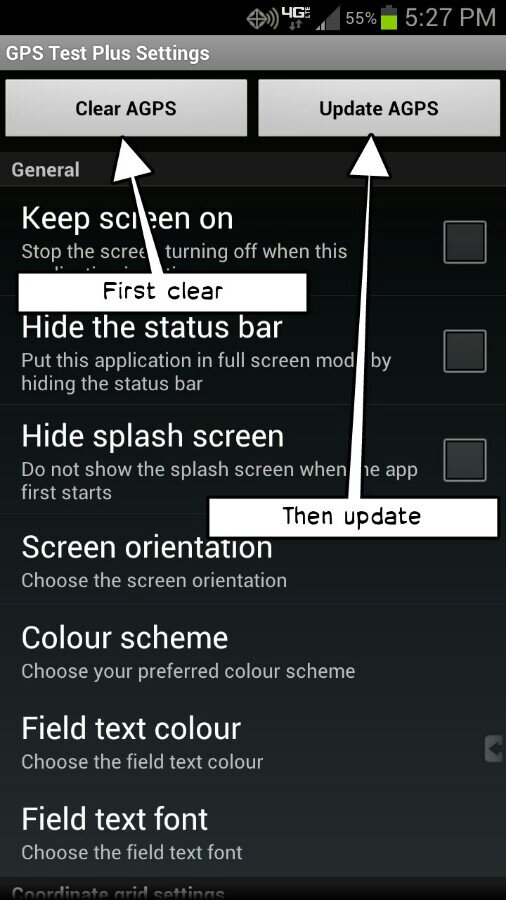

Tried everything
What does "tried everything" entail? Have you used something like GPS Test: https://forums.androidcentral.com/e...ails?id=com.chartcross.gpstest&token=x8_3cPiH to see how many satellites your phone actually sees? Are you using the phone outside where you have a clear line-of-sight to the sky? Have you tried updating the GPS almanac?
