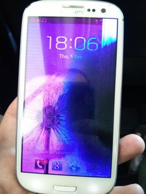

A few days ago my s3's screen stopped working.
The phone is working and I can receive and answer calls using the headset.
Initially the screen was just black and sometimes when i'll try it a purple line will flicker on the right side. A few hours later the screen came back, a bit blurred and with a big ink like, half circle, mark. Even then, it didn't respond to touch.
Then it turned all black again and stayed that way.
I didn't drop the phone (it was dropped about twice but that was a few months ago) or get it wet or anything.
What is the problem with it?
Will Samsung fix it under the warranty?
Thanks,
Yochai

Finally, it certainly appears to be a problem with the digitizer and LCD. It could be that the connector is just coming loose, or that there's some manufacturing defect that takes a long time to manifest. Or perhaps the drops are finally being evidenced.

If you can't get it repaired under warranty then your best bet is to DIY - check out http://m.repairsuniverse.com/samsung-galaxy-s3-screen-assembly-replacement-white.html (it's about $180 for the whole assembly; be sure to get the correct color for your phone). You can find teardown videos online like http://www.ifixit.com/Teardown/Samsung+Galaxy+S+III+Teardown/9391/1
If you're going that route you might as well open it up to verify that the connector hasn't come loose.

It wasn't too difficult.
I watched 2 different Youtube clips, to see how it's done from different angles. Neither were perfect, but together it covered almost everything I needed.
