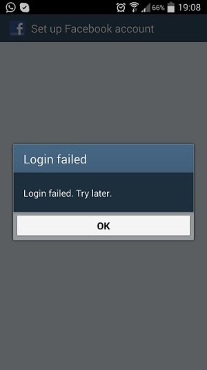

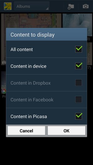

I've restarted my phone, deleted the app and all sorts but I'm still getting this error message about my phone needing to login back into facebook in order to link up with samsung Galaxy, I'm not sure what's going on as before it worked perfectly fine till this morning? I can't get my photo albums on my phone anymore whereas before I had my facebook albums on there, It will only sync contacts that's it! I've removed the account countless of times, removed the app from my facebook web page so I can approve it again however it keeps saying "Login Failed" but my login didn't fail as I am entering my email and password correctly. Anyone have any recommendations?

I have been having the same problem since last Thursday evening, have switched phone on & off have uninstalled facebook and reinstalled and still nothing.I go to log in and get as far as Samsung Galaxy has already been autorised, click ok and then say's log in failed, please try later and been trying everyday since Thursday.

I'm experiencing the same issue (for the past week or so) with my Samsung Galaxy S4. Specifically, the Facebook app works fine and syncs with my contacts. But the "Sync Apps with Facebook" application is unable to sync my calendar or gallery. "Login Failed. Try Again."
I've been having the same problem for a week or so now. I have a Galaxy S4 doing this and so did my wife. Neither of it's could sync our Facebook calendars. I found a solution that worked for both of us. Open the Samsung Apps app and search for a program called SNS Provider. It should already be installed on your phone because it's the Samsung Single Sign On service. There should be an update available. Install the update and try again. The next time you try to login you shouldn't get an error. Good luck! It worked for both my wife and me.

this is the confirmed soution
“Facebook Sync Login Failed, Try Again."
FIXED: Solution: samsung single sign on service not updated.
Update it via samsung apps and enjoy.
Thank you so much for this post. I had tried everything else. Updating the SNS is the only thing that worked. Now both mine and my husbands new devices are working again.
