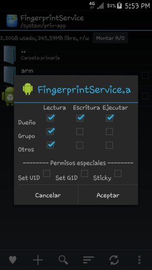

Hi guys, I think I found the ultimate solution to this problem, after trying all possible methods, well, we must first become root, then we must have a file manager, I have root explorer, and in the application vamo the following directory : system> priv app> fingerprintservice> here pose finger on FINGERSERVICE.APK and give permissions and mark the first box to the right of the row that says run .... the above and give you accept, restart the s5 and you should be running smoothly.
