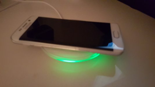

S6's New Circular Wireless Charging Pad: Always ON LED! Not good for bedside!

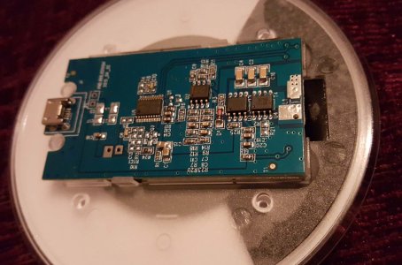

Once you have separated the two halves you'll see 4 small hex screws holding the charging element in the base - unscrew these to remove the middle section:
middle section close up:

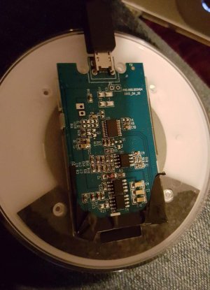

The annoying LEDs are on the PCB at each outside edge of the solder points:

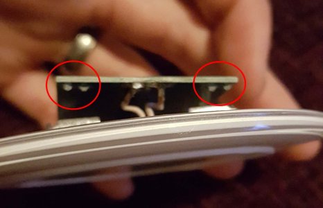

Turn the board over and gently prise the PCB upward and using a small craft knife cut the LED lights off the board:

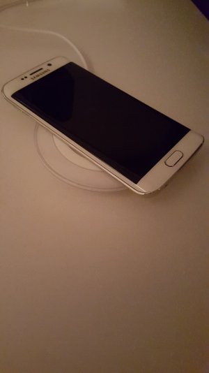

Black nail polish is the easy way !!! Just had the idea last night and work perfectly !! Dont know how To post picture on this forum but even a jeweler wouldnt notice !!!! My sleep s gona be so much better tonight. ......
