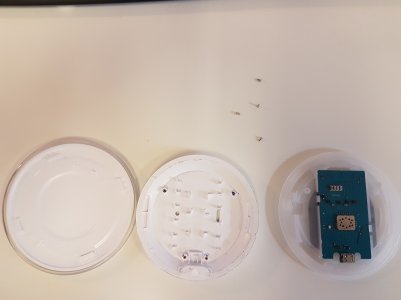

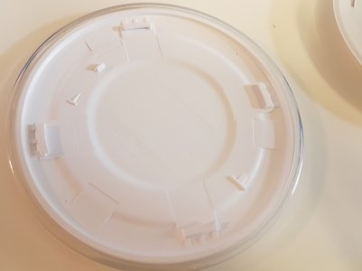

The wireless charger isn't held together with screws, it has small clips on the inside that locate into recesses - so it opens like a jam jar:

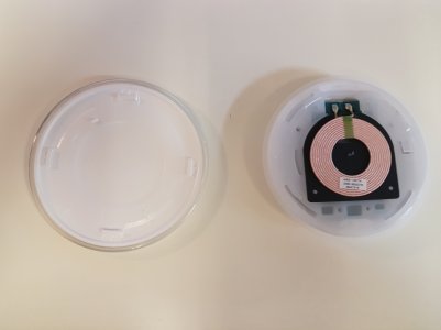

Hold the base in one hand (with the top of the charger facing upward) and rotate the bottom section clockwise and the top section anti-clockwise and it will twist apart. NB: this took quite a while because both parts are difficult to get a grip on!
Once you have separated the two halves you'll see 4 small hex screws holding the charging element in the base - unscrew these to remove the middle section:

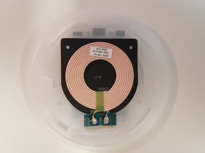

middle section close up:

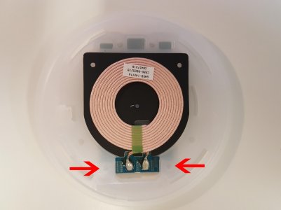

The annoying LEDs are on the PCB at each outside edge of the solder points:

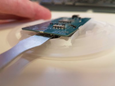

Turn the board over and gently prise the PCB upward and using a small craft knife cut the LED lights off the board:
Then reassemble the charger and relocate the top and bottom parts together screwing them in opposite directions to lock them back in to place... making sure you align the Samsung logo to the top!
