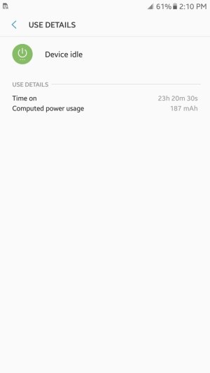

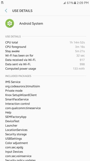

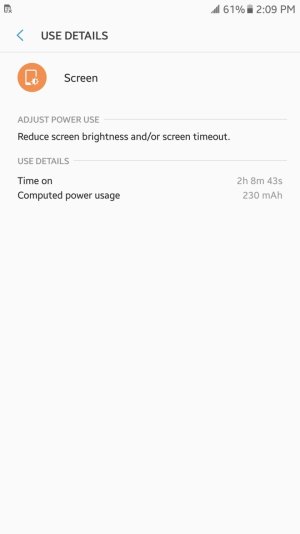

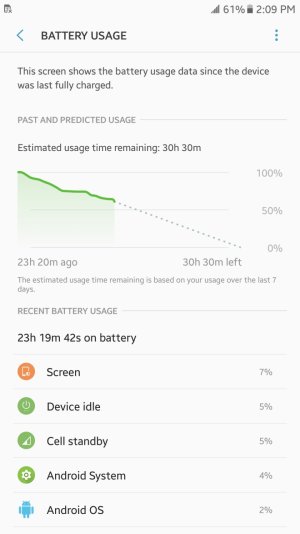

these are my battery usage for the moment
What I wouldn't give to have percentages like that on my phone... That's what these stats should look like on a normal phone!
Unfortunately, mine are disastrous.
In order to see something like in your pictures, I have to look at a Samsung Galaxy S6's Battery Stats.
However, your example shows me, what I want is not some unreasonable and impossible dream, but can actually be achieved.
Only how? I will continue at this, until I figure out the answer.
EDIT: Would you mind installing some apps to further monitor your battery, and give us more answers?
