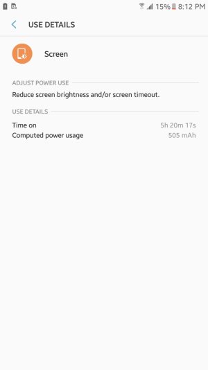

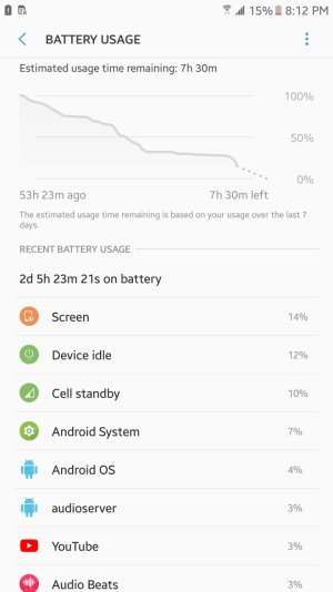

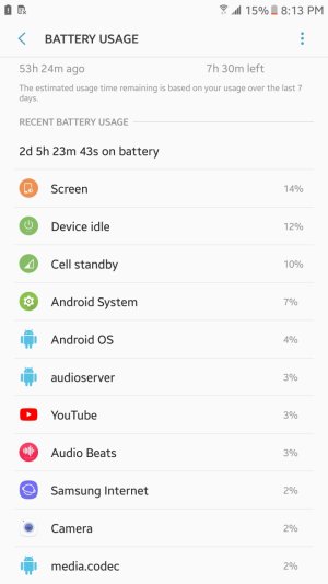

here are the latest screenshots of my battery usage with 15% remaining of the battery.
Your stats look normal. I would LOVE to have stats like that!
Unfortunately I can not get Android System off the top of the list.
Also, that's some amazing battery life you have! 2 days? Wow.
Do you have Wi-Fi and/or Mobile Data enabled at all? I mean in the screenshot Wi-Fi is ON, but otherwise?
my wifi is enabled with like 6 hours of that total screen on time..But that 5 hours 20 minutes is of SOT is like not enough i used to have 6 hours to 7 hours back on Marshmallow. By the way what Version of s7 edge you have do you have the
