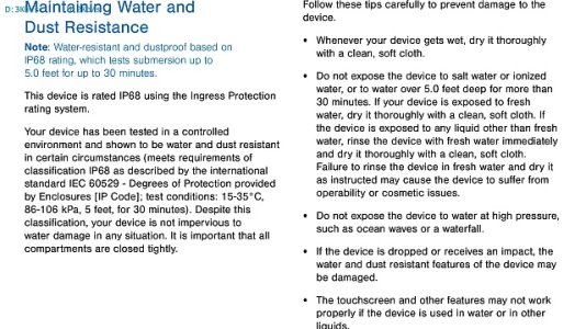

We all need to understand what the IP86 spec says, what it means, and what Samsung says about water. THIS IS NOT A WATERPROOF PHONE.
The 8 in IP68 means the phone can sit in still water. Not flowing water or water under pressure. There are different IP specs for that. And a higher number doesn't automatically mean a higher level of protection. IPx1 through IPx4 are for splashing water, with 1 being equivalent to light rain, and 2 through 4 progressively harder. IPx5 and 6 are for flowing water. The fact that something passes an IPx8 test doesn't mean it also passed, or will pass, a flowing water standard. Flowing water applies pressure to openings that simply sitting in water might not.
Not soapy water (yeah, there was a thread about that on another forum). Soap acts as a lubricant, and makes water more slippery, and could allow water to infiltrate openings that plain water won't.
Not salt water, or water with other contaminants (don't wash your phone is a mixture of water and clorox!). That should be obvious.
Finally, what does Samsung say about water?
Do not expose the device to water moving with force, such as running water from taps,ocean waves, or waterfalls
All that said, I agree that Samsung's advertising is a bit misleading, and the warning not to expose it to water from taps is not made clear in any of the materials a new owner is likely to see.

There's too much pressure from running water. The phone wasn't defective. You want to take it swimming, you should be fine, but like they said the pressure is too great from flowing water. That's why you can't go below a certain depth with the rating they give. The deeper you go, the higher the pressure

Really doesn't matter if its not that strong, it says don't expose the phone to running water. Any running water is more then the phone is certified for. I agree that the way Samsung advertises the feature makes it confusing, and they probably shouldn't but it is what it is. Either way, glad it worked out for you and you were able to return it.

They know that -- They're just saying there is a lot more pressure if you compare water sitting in a glass versus water flowing out of a faucet. The rating they gave this phone is not meant for "proofing" the phone. It is more so meant for accidental spills or if you're talking on the phone and it starts to rain some you won't have to freak out and worry about your phone.
Yes, however, the Samsung manual says to rinse your phone off if other liquids (besides regular water, such as pool water) get on it.. why would they tell you to "rinse it" if you can't use running water? How would you do that?
