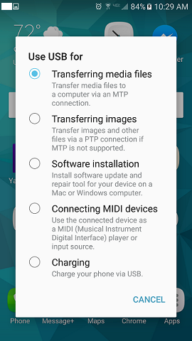

Same problem here. You can not select an option to use USB for file transfer if that option is not available. That is the issue here. Plug in the USB and all I get is the popup saying that it is charging. NO possibility of making another choice because it does not exist. Charging only. This was with the cable that came with the phone. GO AND BUY A BETTER CABLE!!! I went and bought a Belkin $29 cable that was a higher grade and for file transfers. Plugged it in and IMMEDIATELY a window popped up asking what I wanted to do with the USB connection. Problem fixed.
