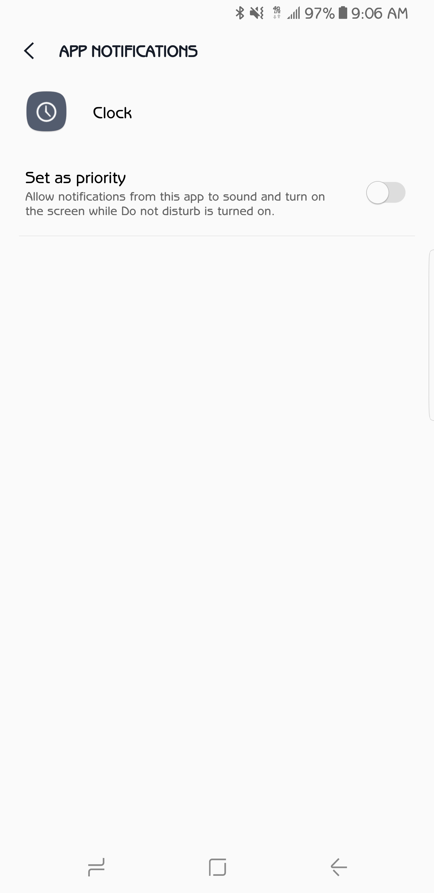

You need to go in to settings then select Notifications The and select your alarm clock app And then make it a priority .

I wonder where you guys are finding the setting in settings->notifications to set it to priority. Looking at notifications screen, I won't see clock unless l click on advanced at the top right (not listed in the main list before it). The option that pops up is to show content on lock screen. Nothing about priority. Same thing when accessing this setting via the app properties.
