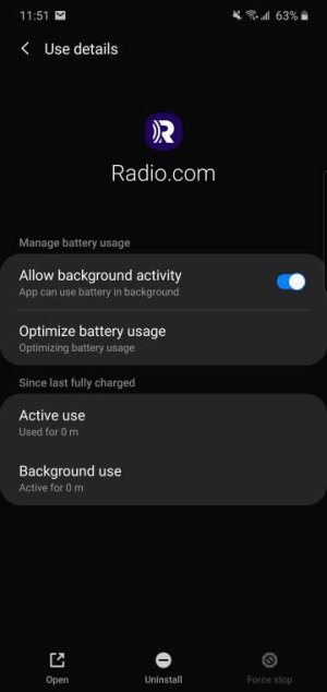

Re: same old **** s9 cuts out streaming after 5 minutes or less
Allow background activity for those apps, also no power saving modes like medium setting , or try high performance mode Screenshot_20191119-235117_Settings.jpeg
I am following all your suggestions Mustang thank you for your suggestions, still however looking for a solution. Until Samsung chimes in and acknowledges the problem, and a solution, or 9 months pass and I can dump this phone I believe I an stuck.
