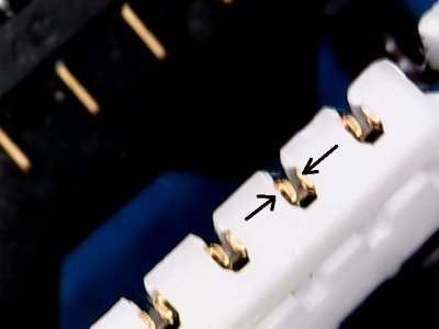

This one has a good contact with battery connector on mainboard

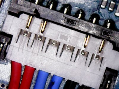

This one, two cables on the left side, have no contact

Try to squeeze the tip of battery cables , you will see the difference. This is not a guessing opinion as I did fix many tablets with this problem. The two pictures above can tell the obvious difference.
