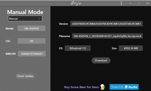

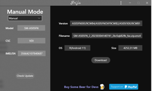

I tried to find the model and CSC and IMEI on my original box.
The model is SM 6 A505FN/DS and IMEI is the number from the screenshot.
I bought the phone in Ireland but they have 2 CSC. I ran it with each and there is a difference in the version so im not sure if it helps

I deleted your photos , you don't want someone getting the IMEI numbers of your device.
If it's stuck at the Samsung Logo it might not recognize your device which u need to go in download mode and flash with Odin but get your firmware from SamMobile or Samfirm that latest version
