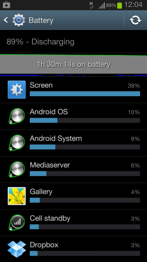

My phone 5 minutes ago..non rooted..updated..zero battery issues.
Sent from my SGN2 on the Sprint network.

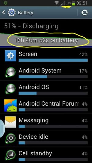

Here is screenshot of my battery today.
Only thin I did was to send few txts, Upload few photos on facebook and whatsapp and took some photos (5-6) with camera) with screen brightness on auto.
I did had day or two ago OTA security update or something. Maybye thats the reason for that battery drain?
