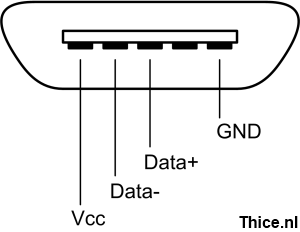

With micro USB the two outside pins carry current (V+ & GND) and two of the inside pins are for carrying data.
USB 2.0 standard is for 500mA of current
USB 3.0 standard is for up to 900mA of current
When plugged into a computer one would also have a data connection for the transfer of files, pictures, etc... so the data pins remain active.
Dedicated chargers can have up to 2,100 mA of current passing through the outside wires.
Obviously your charger is not going to transfer any information...
There are some various protocols for dedicated charging ports among different device manufacturers, but having D+ & D- shorted to each other signals the device not to expect any data and to allow as much current to flow as the device can handle.
From Wiki;
Charging ports and accessory charging adapters
The USB Battery Charging Specification of 2007 defines new types of USB ports, charging ports.[57] As compared to standard downstream ports, where a portable device can only draw more than 100 mA current after digital negotiation with the host or hub, charging ports can supply currents above 500 mA without digital negotiation. A charging port supplies up to 500 mA at 5 V, up to the rated current at 3.6 V or more, and drop its output voltage if the portable device attempts to draw more than the rated current. The charger port may shut down if the load is too high.
Charging ports exist in two flavors: charging downstream ports (CDP), supporting data transfers as well, and dedicated charging ports (DCP), without data support. A portable device can recognize the type of USB port from the way the D+ and D- pins are connected. For example, on a dedicated charging port, the D+ and D- pins are shorted. With charging downstream ports, current passing through the thin ground wire may interfere with high-speed data signals. Therefore, current draw may not exceed 900 mA during high-speed data transfer. A dedicated charge port may have a rated current between 500 and 1,500 mA. For all charging ports, there is maximum current of 5 A, as long as the connector can handle the current (standard USB 2.0 A-connectors are rated at 1.5 A).
Before the battery charging specification was defined, there was no standardized way for the portable device to inquire how much current was available. For example, Apple's iPod and iPhone chargers indicate the available current by voltages on the D- and D+ lines. When D+ = D- = 2 V, the device may pull up to 500 mA. When D+ = 2.0 V and D- = 2.8 V, the device may pull up to 1 A of current.[58] When D+ = 2.8 V and D- = 2.0 V, the device may pull up to 2 A of current.[59]
If you have a DMM with some small probes you can check for continuity between the data pins.
In the diagram the unlabled pin is 'sense' and used for USB OTG.
Hope this helps.
