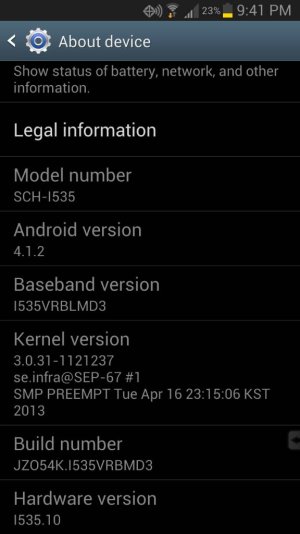

CarrieAnn71272,
Sorry to hear that you're having problems. It sounds like you're having a different problem than what this thread is mainly discussing (problems connecting to WiFi after the last firmware update to 4.1.2).
But we'll try to help you if we can.
When you say that your signal is at 4 bars, you are referring to the cellular signal (the stair-step icon) and not the WiFi signal (the curved lines with up/down arrows below it), right? With 4 bars of cellular signal you should have absolutely no problem making calls.
Can you post a screenshot of your firmware information? From any Home screen, press the Menu button, select Settings, scroll down and select "About phone", then scroll to the bottom and take a screenshot - it'll look something like this (although this information is from a Verizon phone)uploadfromtaptalk1371098611621.jpgIf you have already tried rebooting the phone, and if you've already done a battery pull, then it may be that a Factory Reset is the next logical step. To ensure that you don't lose any important information, do the following:
