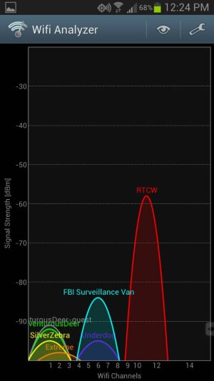

Hey, how many of you guys are having S3 connectivity problems using dual band 2.4/5G routers? and/or are trying to connect in areas with a lot of wifi networks nearby? .I as k b/c i think that either or both of these may be the source of my connectivity problems.
Re: Samsung Galaxy S3 wifi connection problems since firmware upgrade
How many is "alot"?uploadfromtaptalk1369605828609.jpgIf there are several other access points in your area, you should be careful to select a channel that doesn't overlap with the others (if at all possible, as shown in the screenshot). Use something like Wifi Analyzer: http://market.android.com/details?id=com.farproc.wifi.analyzer to determine what's going on in your area and adjust accordingly.

"FBI Surveilance Van"? I made the channel change and the signal quality is better. I still wonder if the bad connection is from using a single band router.
