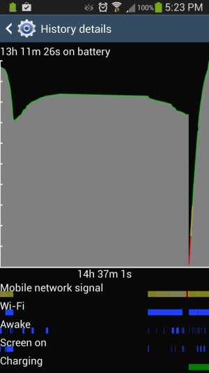

Here is a screenshot of my battery history of when the problem occurred.

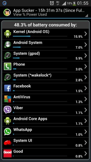

I have been using S4 since its launch in India. Since a few days the battery has started draining out like crazy. Before I used to be left with 30% battery with average use of the phone. I installed gsam battery monitor pro . I am still not able to figure out what is draining the battery. Attaching the screen shot of the battery usage.Screenshot_2013-10-11-01-55-07.jpg
