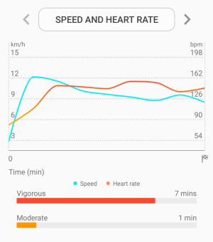

I did a 1.7km run a short time ago. My approach was GPS only, no auto pause, standalone mode.
I "warmed up the GPS" with a "fake run" for 8 minutes (and then ended the run)
Went for the real run, watching my watch :)
I didn't pay attention to the time taken for a GPS lock, but it took 20 seconds to register the 1st 10 meters. And my second device had already got 70m.
Here is the S Health graph for pace which looks odd
Here is the Strava Graph from a GPX export from the watch
I definitely started the run at a normal pace, so perhaps the lock is the issue
