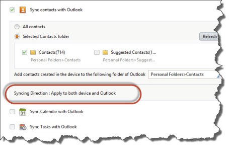

Today my Samsung Galaxy S3 (GT-I9300RWDBTU? WK37) phone offered a firmware upgraded to Android v4.3 which I accepted. When I then went to sync my my Microsoft Outlook 2010 Contacts with my phone using Samsung Kies (as I've always done) it said I needed to upgrade my installed version of Samsung Kies as existing version 2 was not compatiable with the new firmware on the phone. I did so and now have Samsung Kies version 3.2.13114_22.
However, when I select to Sync my selected Contacts folder from Outlook 2010, Kies ONLY gives a sync direction option of "Apply to both device and Outlook". See attached screengrab. There is no option to change the sync direction, which there used to be in Kies v2. I used to be able to just apply the Contacts changes to my device, and this is what I want to do as I do not want or trust the Kies app to do anything to my Contacts as in Outlook 2010.
Is this a known bug or limitation with Kies 3 and Android v4.3 or is there a workaround?
I guess it's a feature change, although I'm not sure why Samsung would have made that design decision.
There's at least one other thread complaining about Kies and Outlook issues, and someone mentioned an app that they now use to sync between the two. I'll see if I can find that for you.
Thanks for your response. I actually submitted a ticket to Samsung Customer Support about this and they have replied as follows:
"Regarding your issue, I can confirm that the option to change the sync direction has been removed from Kies 3.0. I am unsure of exactly why this feature was removed but i will pass your concerns on to the Kies development team. Hopefully the next update of Kies includes this feature".
Hmmm, very disappointing :?(

That linked thread suggests using the Outlook Connector but I cannot see how that would be any use for just syncing Outlook computer based client to Android contacts on the phone. I did search for "outlook" and only other app which has been suggested which sounded hopeful was MyPhoneExplorer (as from FJ Software Development). However, on trying to install that my A/V program tells me it contains dodgy stuff so I'm unwilling to install that. Don't really know what I'm going to do now. Am really p****d off with Samsung for removing the extra sync directional options from v3!!

Sync directional options restored with latest version of Kies 3
Success! Yesterday a message popped up saying there was a new version of Kies 3 available for download. I downloaded and installed the new version (Kies 3 v 3.2.14013_45 ). This latest version has restored the directional options when syncing my Contacts between Outlook and my phone. Now I can choose from "Apply to device only" or "Apply to Oulook only", and "Apply to both device and Outlook".
I tried a sync with my preferred setting of "Apply to device only" and on first few attempts it stalled at around 40% with an the error message: "An error has ocurred while preparing to sync contacts. Task cancelled". I experimented with opening and closing Outlook and Kies a few times and eventually it's now doing a full sync OK. :):):)
Also, in response to that last post about latest version not syncing correctly. I just tested adding a new contact in my Outlook contacts. I then ran a sync to my phone with Kies 3 and it HAS synced that new contact across for me, so seems to be working fine.

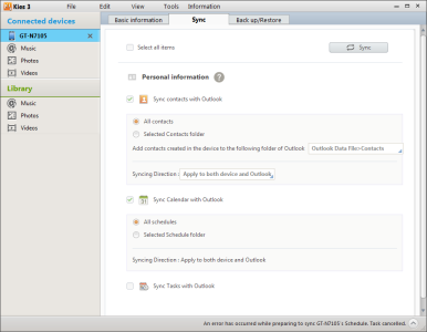

Hi, I've had the same problem using Galaxy Note 2 with Android 4.3, Kies V3.0.14013_45 and Outlook 2010. This was working fine, to a fashion, still had to do some manual changes to my Outlook diary every so often but it worked. Then I did the Kies upgrade to the above and now it wont even synch! Grrr! I just get the error below:
Looks like the error deals with the Schedule - you could temporarily uncheck the Calendar and see if the sync proceeds; or perhaps pick a specific Schedule folder; or maybe setting the sync to just one direction (Outlook -> phone) will make a difference.
Or you could just try the solution mentioned in post #9.
