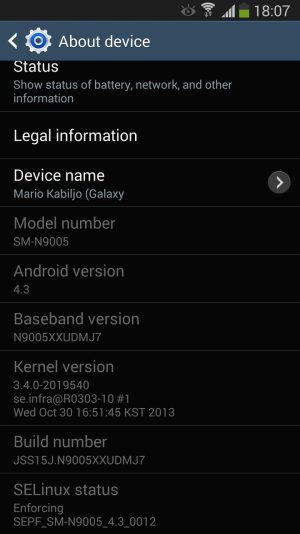

Just wait for the MJ7 update. Its as simple as that.
