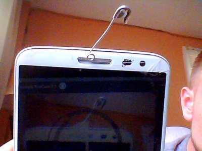

just wanted to share what i found solved my screen goin black during call and not turning back on without soft reset....i took a safety pin and slowley put it through the left side of the ear piece, under the face of the phone,and above the prox. and light sensor. BANG came right back on. took it out. didnt work. slowly slid back in, works fine. i ll just snip it and leave it in there. SEE PICTURE

IDK BUT I KINDA DONT WANT A PIN STICKING OUT OF MY PHONE LOL WHATS ANOTHER WAY TO SOLVE IT....CNT U JUST COVER IT WITH TAYPE OR WONT WORK ANYWAY ....IDK BUT MY PHONE GOES DARK DURING CALL AND KNOCK ON WONT WORK BUT WILL KNOCK OF
well I don't know about you but this guy would probably cut the pin and turn it the other way so it would stay in there so it's just a piece of metal underneath the phone screen I'm sure there's plenty other pieces of metal underneath the phone screen you just happen to be able to see this one. By the way I did cut the pin and turned it and it works great you can't put tape over it because then it won't work at all it has to have some light and I think the pin maybe reflects some of the light the way and some of it and I don't know if it worked😃😄😀
