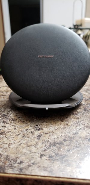

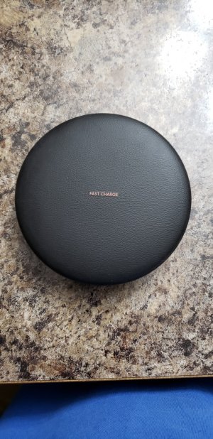

I've been using the charger that came with the note9. From time to time I use the Samsung wireless charger i got as a freebie from either note8 or note7. Couldn't remember which one lol. Here is a pic of the version I got. Is this the one you using?
Man those are nice. This is the one I'm going to try.
