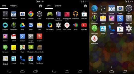

WHAT IT DO:
--Delete unnecessary apps preloaded by popular roms (CM, AOKP, PA, Slim).
--Delete unnecessary Google apps downloadable from PlayStore (important core Google services are kept).
--Delete unneeded media files from the "/system/media" directory.
--Delete non-English PicoTTS's languages.
--Copy everything from the "system" folder from the zip file to the /system partition of the device.

Ok so I am on the stock ROM at the moment but when I do flash a ROM I'll give this a test run to remove Apollo or some other bloat that's added to ROMs. Thanks for your nice simple tools that make our lives easier.
