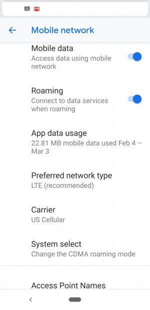

Removing and reinstalling SIM didn't work. Now I'm on your 2nd method, but what do you mean "update device configuration'? I don't see that option under "advanced"
Here's my screen at the point of "Advanced" under Mobile Network

Try Settings > Network & Internet > Mobile Network > Advanced > Carrier settings > Update Device config
"Home only" and "Automatic" - I tried both without success

There is not a "Update Device Configuration" option. Just "Carrier" and when I go under than, it reads "US Cellular" and "Add Carrier"
Here's the options I have under "Advanced"

When you are on the mobile network screen, when you hit advanced, you should see carrier settings on the bottom of the list.

I don't have that option on my phone - as in the above screenshot, the bottom-most option is "access point names". I can't scroll further down. That screenshot shows the complete list of options under Mobile Network>advanced
I spoke with US Celluar technical support. He's says it's not a message he's seen before, but it is indicating my phone is not currently roaming, which is true. So Maybe it's just something that's there that's supposed to be there, or some bug that might get fixed with a future update. It seems ***-backward, though. And I hope it tells me when I'm roaming. Because THAT I would want to know, I don't really care to know I'm "not roaming" and that my "roaming indicator is off" - I can see that. Just like I wouldn't need to see a scrolling message on the phone that "wifi indicator is off" or bluetooth indicator is off" . So I'll just live with it. it's not a constant thing.
