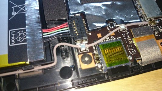

I do have the same problem, so I opened up and found the memory card slot is a rather flimsy construction. The card is inserted with the copper connection strips facing toward the back cover, but the slot connection strips are on a plastic film which has no real structure, firmness so as the unit is moved around or in my case even witout that contact lost several times Memory Card Slot.jpg,
