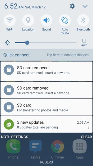

I just happen to catch a set of notifications on my s7 where the SD was being ejected and mounted again. My phone is just charging and I was not doing anything other than powering on the phone to the lock screen.
1) this explains the random SD card notification that appears from time to time even though there was no phone restart
2) this likely explains why when an app is moved to SD, the app drawer shortcut switches between non-working and working at random times.
hopefully an update from Samsung can fix this issue. Or this could be a hardware SD card problem. I have the Samsung 64GB class 10 sd card from the Best Buy bundle.

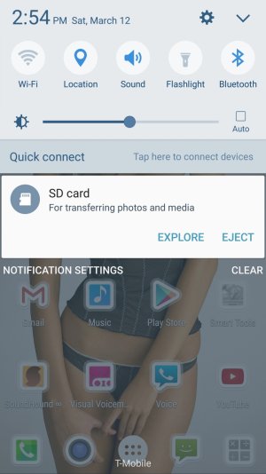

I get this all the time, too. Notification keeps popping up. It doesn't mount or unmount....it just simply keeps popping up on the notification screen. Very annoying.
Yep. Same issue here with the SanDisk Extreme 64GB Class 10 U3. I've only seen the notification pop up when I power up the phone. It swipes away easily. There appears to be no issue with reading the card because I can take photos and they store to the card and I can easily read them on the device.

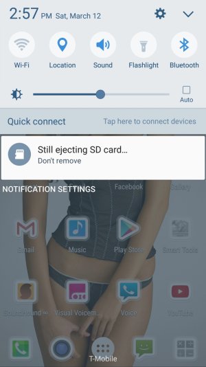

I'm having the same issue. I'm using the PNY 64 GB U3 card. It ejects itself and re-mounts itself many times throughout the day, especially when I'm downloading files to the SD card. Sounds like it might be an OS issue with the S7? Or possibly even a loose connection inside the sim/micro sd slot? I doubt it's the SD card, sounds like we're all using different brands.
