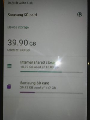

Image 1 shows that SD is reported OK

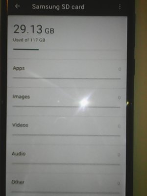

Image 2 the 0 files i see when i tap on this storage option

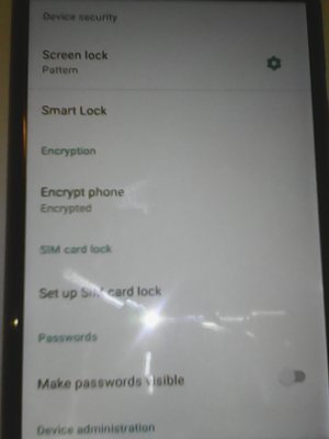

Image 3 that there is no decrypt sd card feature

Check the first image where it asks you if the SD will be the default write disk and the radio button that is checked
I assume everything you store from that point on will be stored to sd and used as internal storage but this is my perception
The problem is that the SD shows 0 files making me think that either the partition or the file system is corrupted in a way
The issue is that i don't know how to correct it (if this is the reason of the problem of course)
