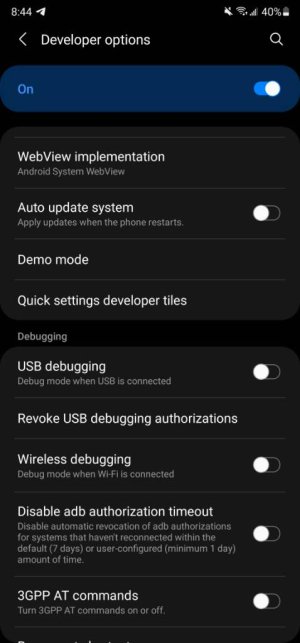

Do u have developer settings on and turn off sensors under quick settings developer tiles?Screenshot_20210310-204427_Settings.jpgScreenshot_20210310-204433_Settings.jpg

Hi, I do have developer options turned on but the "sensors off" setting is off, however right now they are working. I will check that again when they stop working again but why would it start doing that on its own when it never did before?
I will report back. I really appreciate the reply, now I have something to check when it does that again.
Re: Sensors stop working for not reason. Fine after reboot but then stop again.
Yeah keep a eye , if that setting was turned on for some reason it can create a quick toggle in notification panel and can get activated that way, let me know what you find .

Edit: Here is what is funny, just for fun I went in and turned the "Sensors off" settings to on but the Sensors app still sees all the sensors. They still worked.
So I am unsure what that setting does but it does not turn the sensors off. I assume it simply allows other apps to do so?
Maybe was a glitch with developer settings on or reboot fixed a glitch , let see couple more days.
