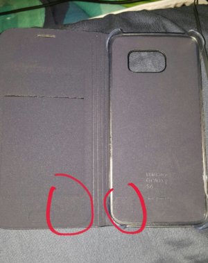

There are 2 magnets, one in the back of the case in the bottom left, the other one is in the front of the case in the bottom right. I would post a screen shot but the material design android central app keeps crashing when I try to add a picture

Okay finally got to a computer, here you go!
The magnet on the back seems to just be there to let the phone know that it's in a flip case because as soon as I put the case on I get an extra option in settings called "accessory" where I can toggle the auto screen on/off with the flip cover.

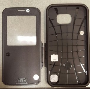

I finally got it working. There is one chip, one magnet and two unknown metal elements. I have transferred them all to a rubberized case, and now I have the sleep/wake function, the simplified view function, and the protective case. :-) Image attached. 20151102_121143-1.jpg

I used a Samsung - S-View Flip Cover for Samsung Galaxy S6 Cell Phones
