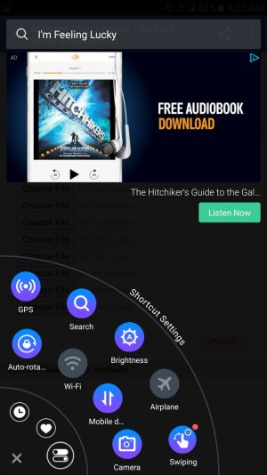

Here is a screen shot of what I'm seeing.

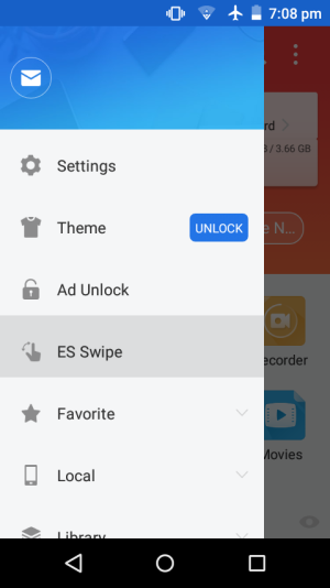

If you are using ES File Explorer, instead of uninstalling it, there is an option called ES Swipe, click it turn it off or on.
