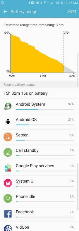

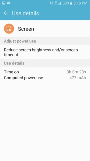

I know this has been gone over a million times but today is my last day to exchange it if I want. My battery life has been terrible from the start. On Saturday I took someone's advice and switched it to CDMA instead of global (I'm on verizon). That day I was able to get 5 hours of on screen time and 20 hours from full charge. That only lasted a day. Here is as of this morning. I love the phone just not sure if I should swap it out and try my luck on a new one.

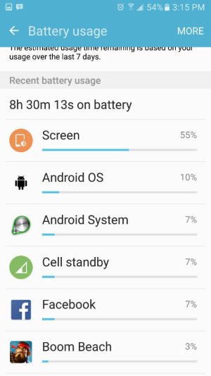

The Facebook app is known to be a battery killer with how it's always constantly running in the background even when not in use. I've switched to an app called Metal. I'm at 51% battery with full charge from 11:45pm last night, and my estimated usage time remaining is 13 hours...I'm also on Verizon as well.

Wow you guys android system is using a lot. My stays between 6-11% . I have the exynos version though. My SOT yesterday was 6:40

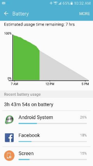

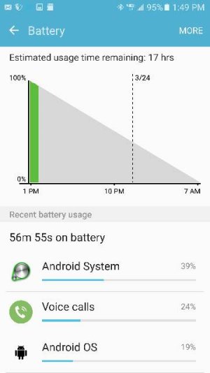

I let my phone charger to 100% and left it on the charger for 10 mins once it hit 100. I rebooted the phone and did not open up facebook at all. Does the info below look accurate with amount of battery time left? I feel like it should be higher, the SOT is only 15 mins.

Not to me, again the android is very high compared to mine .

If screen on time isn't the biggest battery user,there's something wrong. Android system shouldn't be taking up that kind of power. If you're going to return it anyhow, try a factory reset and give it 30 minutes then check what's using the battery.

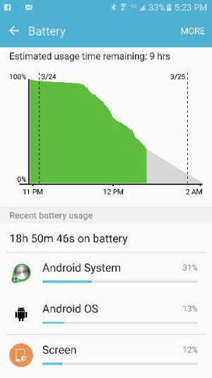

So I took your advice and changed some settings. I did not do a factory reset yet, I wanted to try tweaking the setting first. I tried to clear the cache on the recovery mode but it just kept saying downloading on a blue screen on nothing happened. I charged my phone to 100 percent before bed and unplugged it. With the always on screen function with time turned on, I only lost 3 percent in about 8 hours. This is my usage today, with 3:45 mins of SOT. It seems much better. So thanks for the tips.
